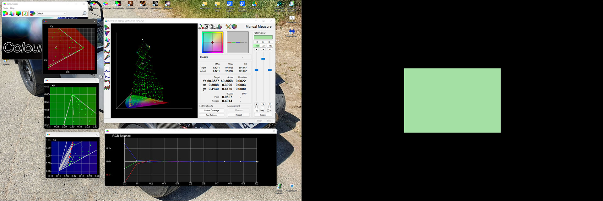

Windows PC Desktop Set-up
To use a PC (normally a laptop) for display profiling via its HDMI output, first connect the display to be calibrated to the HDMI output, set the desktop to Extended mode (not Clone mode), and if necessary, re-start the PC so the display is correctly identified. ColourSpace's in-built EDID Viewer can also be used to review any monitor or TV's EDID info.
Extended Desktop
Extended Desktop
(ColourSpace on PC screen & Patch Window on TV)
Using the graphics card/chip set control program, select the correct display and configure as outlined above.
Open the pop-up colour patch window within ColourSpace, and place on the extended desktop, on the display to be profiled.
Profiling can then be performed as normal.
